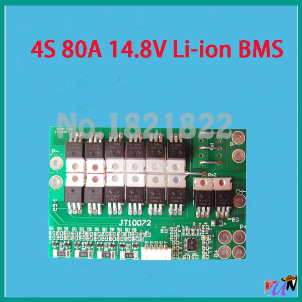

The single most important thing to include in the battery pack is a BMS, or battery manager system. These are a combination of a smart charger and a smart discharger. All of the laptop battery packs have one in them in order to meet safety and liability standards in Europe and America. They can be found as cheap and barebone or expensive and snazzy as you desire on the normal auction websites. More discharge current and higher voltage BMS cost more than low voltage and low drain. Just figure out your peak current draw and max voltage and order accordingly.
Cheaper than dirt $3
Still cheap $7
Not cheap $22
