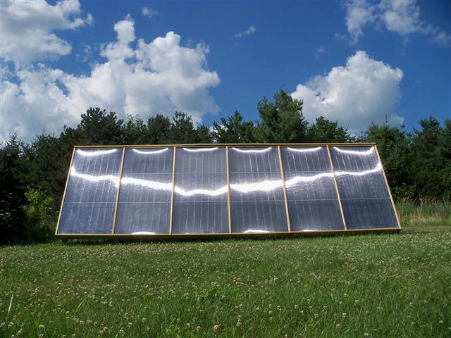

I found this on BuildItSolar a little while back. Its a great install of a fairly large solar water system. I found it interesting how he made the collector separate from the casing. This simplifies somethings and makes other things more complex. Anyway, he goes into some very good detail on how he constructed the panels and shows some nice tricks he came up with.
Solar Hot Water System

I would like to know how much these systems cost, and how you size them.
His collector array is 8'x24', which is big enough to mostly fill my backyard. It would just about cover the south-facing half of the roof of my garage, which is partly shaded by my neighbor's tree.
