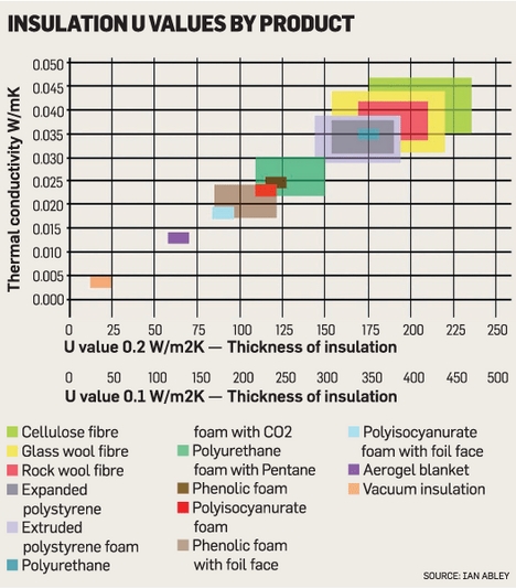

another interesting one.
Click image for larger version
Name:	VIG pg 14.jpg
