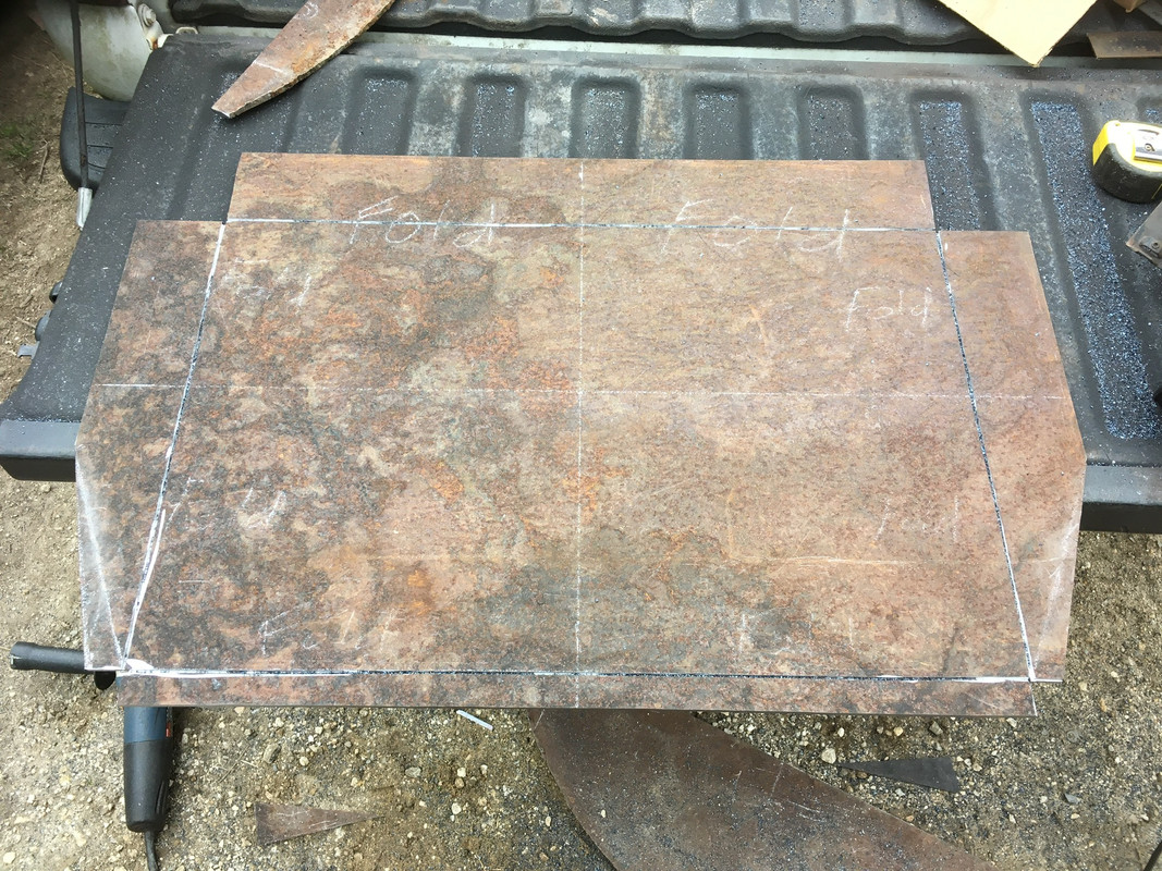

I chose a piece of 1/4” thick steel for the griddle and began laying out and cutting.
Not having access to a large heavy brake to bend up the sides meant that another method would be needed. So instead, I cut almost through the plate on the bend lines, leaving approximately .020” of material. I then clamped the plate to the table and used adjustable wrench’s with a little muscle to bend the plate to the desired position.
