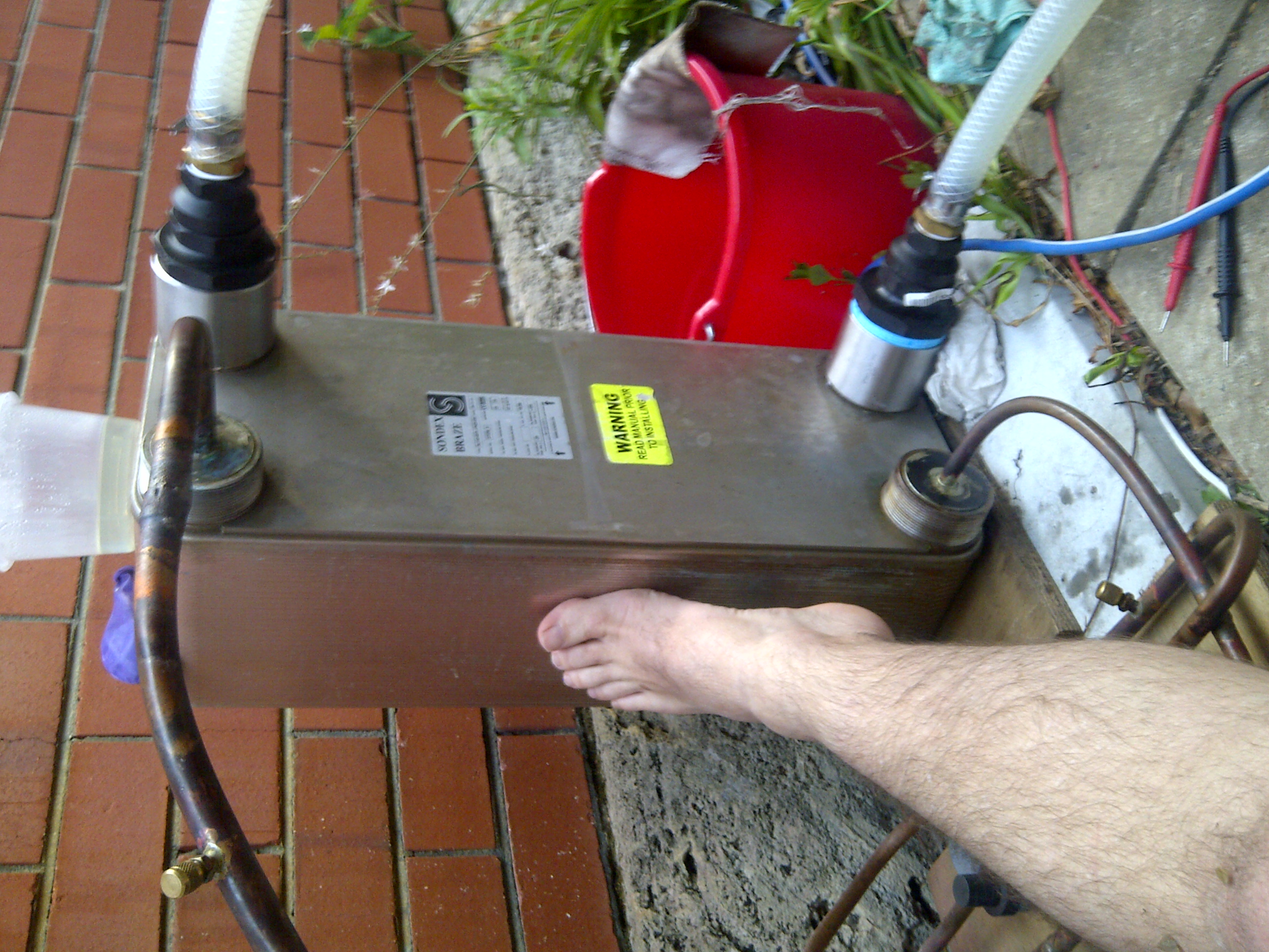

Summary. The as-delivered air cooled configuration was undersized for the house. The condenser was too small for the system (it was a badly designed system to start with which is why I got it for almost nothing).
By replacing the condenser with a large (~8M2 area!) BPHX in an open loop bore water configuration I've increased the system capacity enough that it is now well sized for the house. The total power consumption has dropped, but until I get a chance to set it up and do some proper measurements I won't know properly by how much.

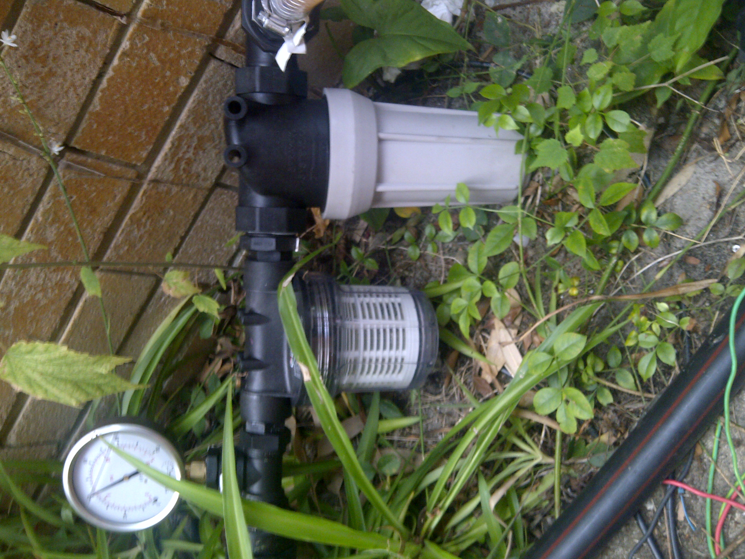

Water fine filter and pre-filter. From memory the fine filter is #100 mesh.

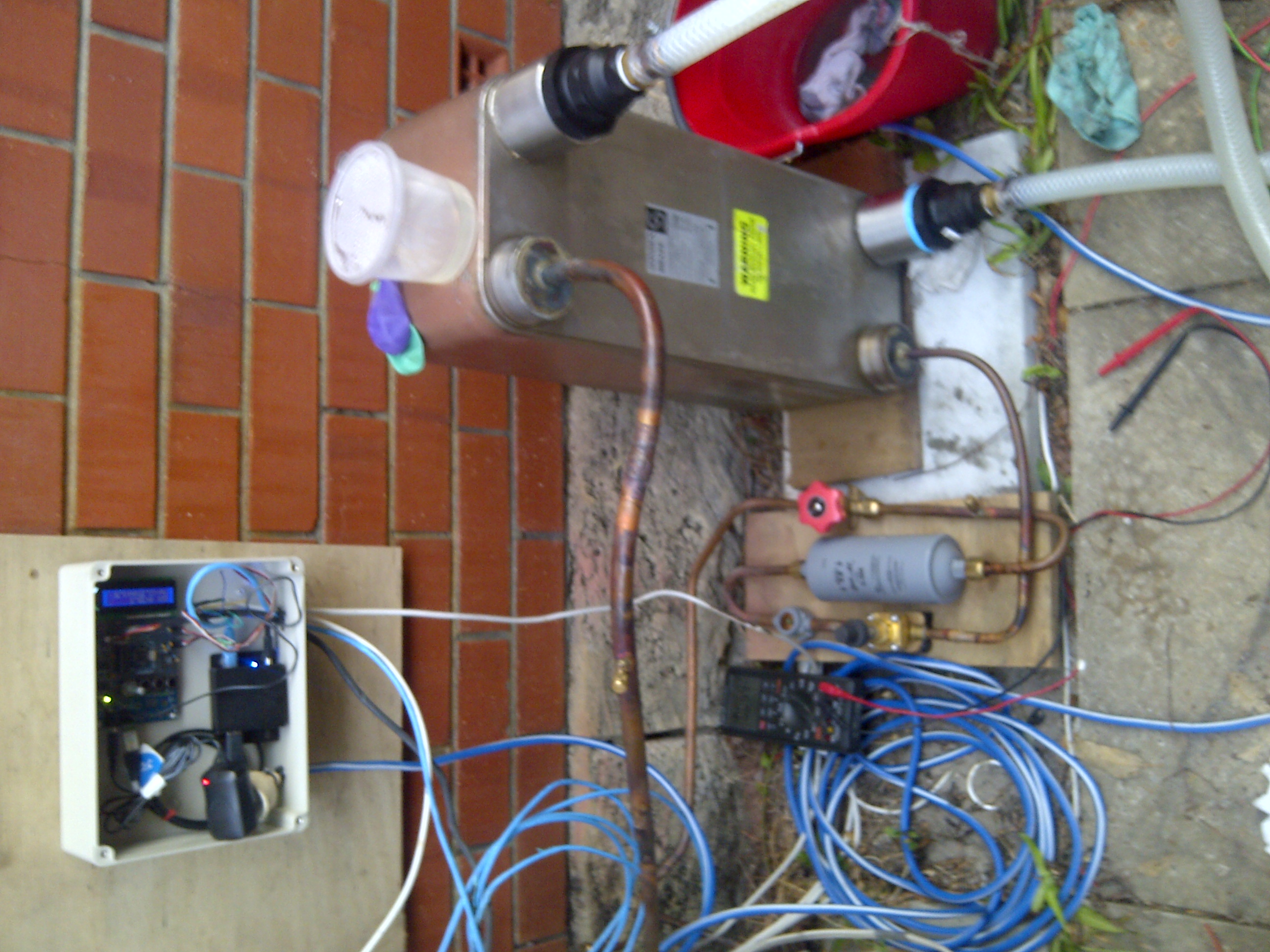

The whole assembly sitting next to the compressor/condenser unit.

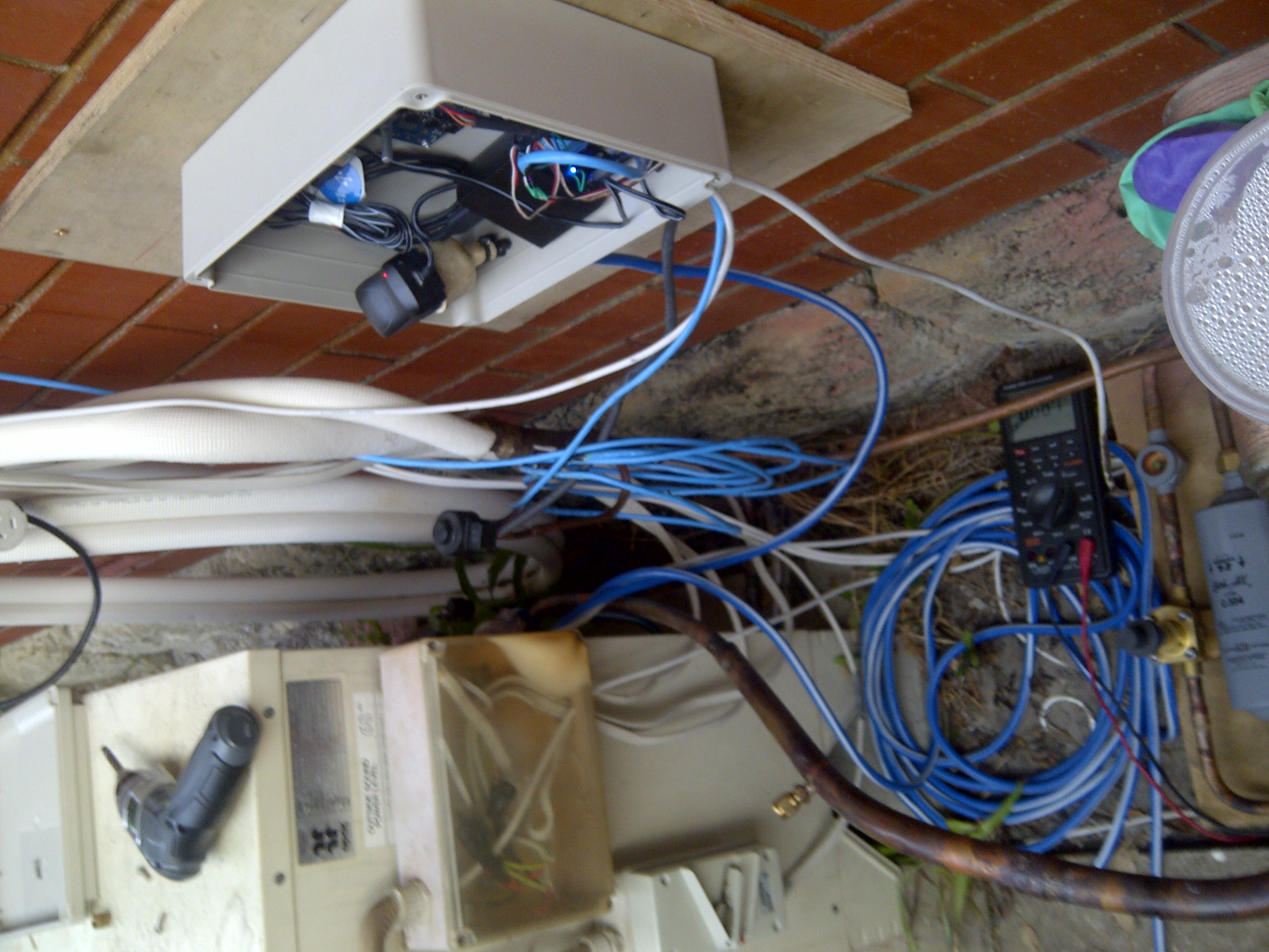

The Rats nest of cabling. The looong blue cable is a CAT-5 that I'm using with a USB extender, so I can tune,tweak & develop without having to go outside. It's all looped around the Ex-Daikin EXV.

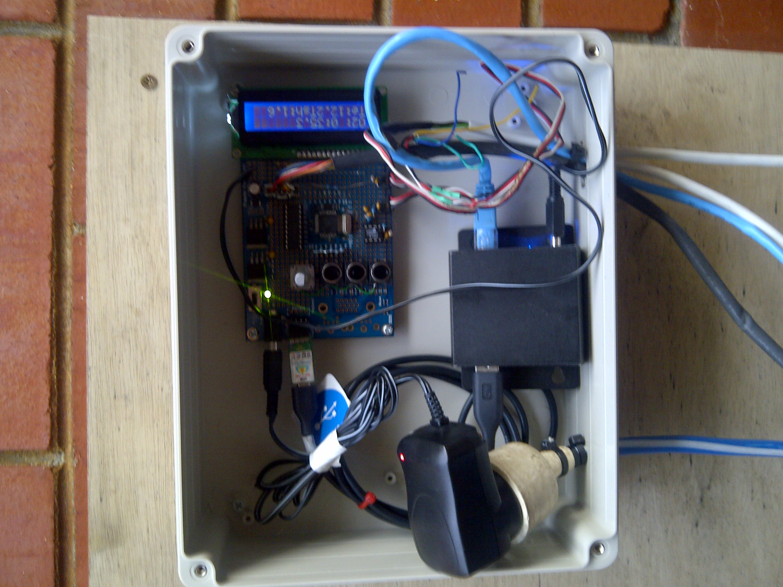

The Smarts. Control board + Dirty PSU and USB extender in a waterproof enclosure.
The BPHX with my foot for scale.
Found a number of nasty bugs in my stepper code today which were causing erratic EXV operation. Also found a neat-o Daikin service manual that details the PI control for their split heads. It confirmed my theory that they use a pair of thermistors for superheat control and not a thermistor and pressure sensor.
I need to re-seat and insulate my gas & vapor line sensors. They are obviously not making good contact with the pipe and therefore reporting a significant heat gain through the insulation. Another weekend job.

I've noticed that air in the water loop causes a massive rise in back pressure in the injection well. It can make the pressure gauge run off the scale (>15PSI). I've manually bled it and got the back pressure back down to about 6 PSI. I'll have to get an automated air bleed valve.
