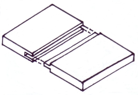

The visible flooring is called 'sub floor', and is lumber milled with 'tongue and groove' to reduce air flow.
