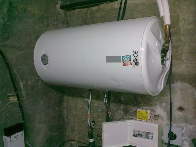

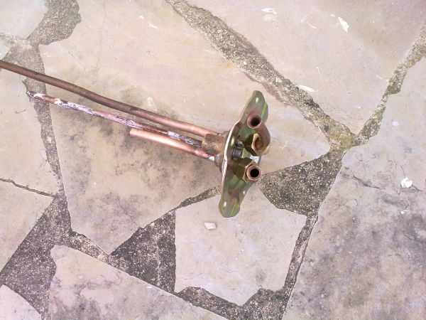

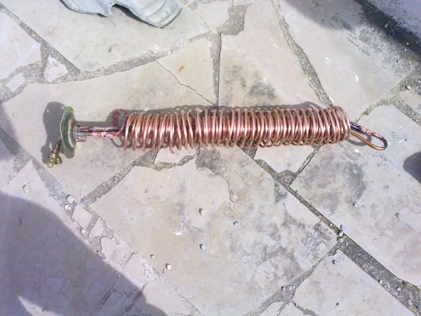

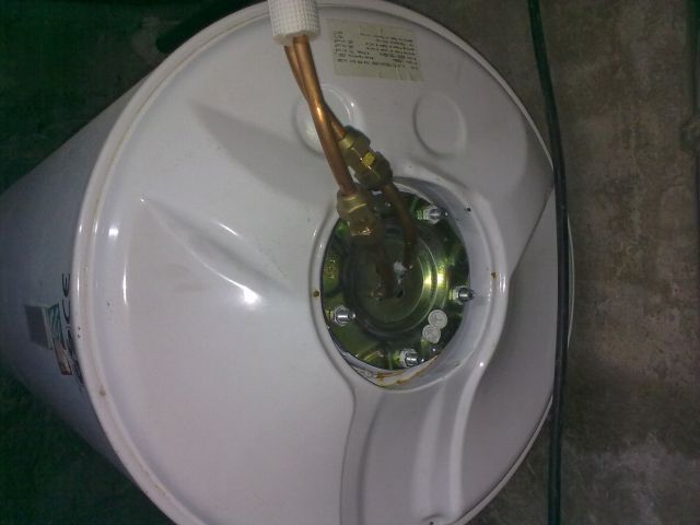

It's suprising what you can thread through a small hole! My latest, ongoing project is using a 100 litre electric water heater as the body of a heat exchanger.
So far I have made a coil (same form as MK2 heat exchanger, 3 coils 1/4" etc....) but with both entry and exit protruding from where the heating element used to live.
I have it piped up to a 5Kw Mitsubishi external unit. It works but at the moment suffers from overheating of the compressor. I'm planning to install a TXV to better control it. I may not progress much though until the autumn as it's getting pretty warm here in the day and I'd have to be out working on the roof in the sun... maybe a (rare!) cloudy day.
My idea is to have this exchanger in series (and before) my oil boiler as an 'accumulator'. My thinking is that I can pre-heat the water going to the boiler thereby reducing the consumption of oil.

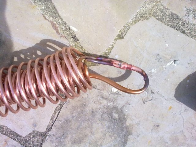

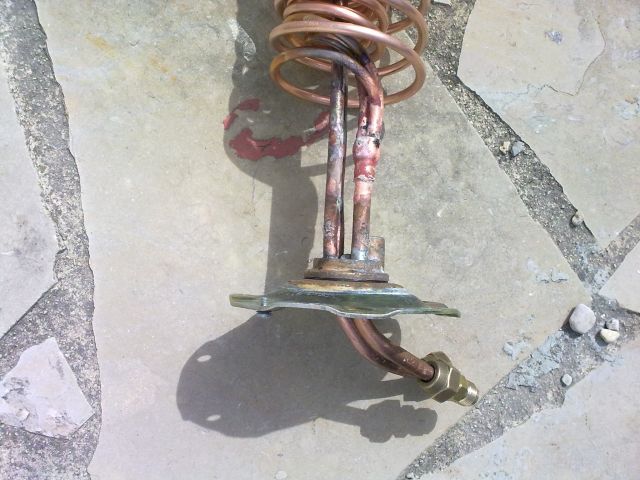

Hey Nigel, that brazing job on the 3-into-1 is amazing.
It seems like the filler has to be filling some really large gaps between the cluster of tubes.
What equipment did you use to make those connections and what kind filler metal was used?

The connection comprises: 3 x 1/4 inch tubes and a 1/2 inch to 3/8 inch reducer. It takes a bit of effort to get the 3 tubes into the reducer but they will go eventually with a bit of persuasion!
The great thing about brazing rather than soldering is that you have much better control over the metal. Soldering using a normal blow torch and plumbing solder gives you very little control as the solder runs way too easily. With brazing you don't seem to have the same problems so it's much easier to fill voids, which is basically what I did.
I don't have any particularly specialised equipment - just a MAPP Gas blow torch. I generally start with a pre-fluxed solder rod to get the metal flowing then finish off with a non-fluxed rod to fill in.
I'm no expert, just determined!
