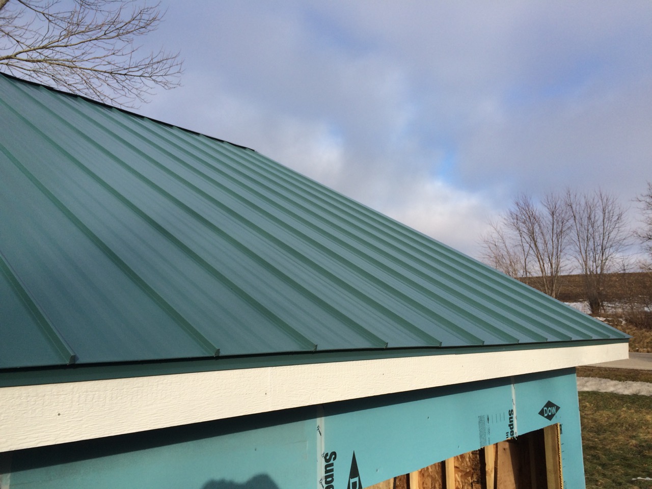

The roofers finally made it out.
The roofing is steel, which comes manufactured already sealed and painted as a big coil of metal.
The roofers have a machine which unrolls the coil and forms it into the profile of the roofing. Each piece of roofing is made as the entire length of the roof from the peak to the bottom edge. There's no breaks, seams, or overlaps anywhere from the top to the bottom. (This process is similar to how "seamless gutters" are made.)
Side to side, each piece overlaps the previous, and covers the screws that hold down that piece. A raised lip, or "standing seam" connects the two pieces and ensures that water can't get between them. Each piece is about 16" wide.
The solar panel racks will clamp on to the standing seam (rather than to a bolt drilled through the roof,) which means that there are NO penetrations in the south side of the roof at all! Zero! It's nearly as leak-proof and permanent of a roof as can be designed.
Here's some photos.
One thing I've noticed so far is that the color of the roof seems to change, depending on the light and the weather. It can look mint green when it's overcast out. When sunny, the color stands out much more the way it should, sort of a bold teal. Please also try to imagine siding on the building, which will be sort of a light buttery yellow, instead of that awful blue-green foam!
The style of this metal roof is called "1-inch nailing strip". You can see a good view of the profile on S-5!'s web page for the N style clamp they sell.
S-5! | Clamps & Brackets | S-5!<sup>®</sup> Clamps | Introduction

That is a good looking roof.

Originally Posted by stevehull View Post
How much was the install per square (100 sq feet)?
Couldn't tell you, as I don't have the final bill yet.
It IS expensive, but it should also last as long as 3 asphalt roofs, be appropriate for rainwater collection, and can attach solar panels WITHOUT penetration.

Just got the final bill from the roofer. Total cost came to $5,400 for materials and installation. It also covered all trim, roof vent and cap, etc. This was within the range originally budgeted for the project. It also included a cost for flashing the two skylights, which was essentially negated by a credit for us doing the roofing felt. (Also the roofer make skylight flashings from scratch for HALF what the flashings cost to buy! - $300 each!)
There was also no separate charge for the man boom that was used. Had I did this myself, I likely would have needed to rent something similar for a few days.
Roof size is 27 feet wide by 18 feet to peak by 2 sides = 972 square feet.
$5,400 /972 is $5.56 per square foot. This is inline with national average costs, although on the higher side based on square footage vs a full size house.
Iv'e also seen estimates for standing seam metal roofing run $7-$13 per installed square foot. And my costs came in BELOW that.
(For an interesting comparison, $5.50 is about the cost of materials for nice pre-finished hardwood flooring at the local home improvement store.) 2017 Metal Roofing Cost Calculator - Install Cost, Metal vs Shingles
That said, the roofers did a good job. It looks nice, and it's well done. It will well outlive any asphalt roofing and NOT need all the solar pulled off to replace shingles!
I also really like that there will be ZERO penetrations in the roof due to solar.
I asked the roofer to cut a couple extra pieces of the metal roofing for me to have as samples, and I ordered a pair of the S-5! metal roofing clamps to test out. That way, I can try them AND have sort of a sample display of how my roof works for teaching events.
