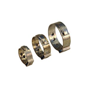

I've also never had issues with PEX connections either. Its quick, easy, and cheap.
I like the 'cinch' crimp fittings. One tool can crimp all sizes. Works like a dream.
